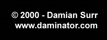

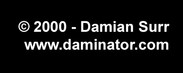

Hello gang
Can anyone explain to me why this ....
(small section of screen, but not zoomed)
turns into this ...
When I compress using DV as the codec?
I've tried the same bit of video using MPG2 at DVD quality settings and it looks perfect. Shouldn't MPG2 at DVD settings be much lower quality than DV?
I have also tried a couple of different DV codec, and have tried exporting through both Premier and VirtualDub. The same effect always occurs.
Below are links to the source files (vary small, just 6 frames) if anyone could take a look for me. I'd very much appreciate it if anyone can work this out. DV was sounding like the perfect way for me to archive my work, but MPG2 seems better at the moment?

First, DV and text don't go well together.
Second, DV-avi is interlaced (hence the artifacts)
Render that DV-avi to M-peg 2 and all will be well. If you're going to use it in a video, you have 2 options, Uncompressed RGB and DV-avi. Either will work fine.

I use the Mainconcept DV codec, and if the Fast option is checked, I get the same artifacts. Uncheck the fast option in the codec and the artifacts should go away, they did for me. If you use another codec, see if there is a "fast" encoder option, or a "low quality" option. In that case, uncheck it. It will use more CPU power, but the quality will be better.
I've just downloaded and tried the 'MainConcept' DV Codec. The results with those few test frames were exactly the same. Still the same at the lower speed setting too.

I can see the exact same artifacts when i use my DV-passthrough of my D8 camcorder (PAL) . It sometimes shows up with certian white subtitles when i record TV-programs with it. When recording a TEST-picture from TV i can also observe those artifacts in the fine vertical test patterns.
Intresting problem this is.
I did some short tests, and i think the problem lies in the DV decoder.
I recorded a short DV video (Type2) from TV with my D8 Camera where those artifacts are visible.
When playing it with the standard mediaplayer the artifacts are visible.
But when loading the clip in VirtualDub using Mainconcept DV Codec 2.4.4 the artifacts are totally GONE!. Also i made a MPEG2 clip of it with Canopus Procoder and there were also no artifacts visible.
So maybe using another DV codec can help?
Daminator:
I tried to load your clip in VirtualDub with the Mainconcept codec and there are NO artifacts visible!!. I just looks fine. -

What software /codec combination are you using when viewing the DV-avi?
Because when I open your avi file with mainconcept and VirtualDub there are NO artifacts visible at all. Only when using the standard MS directshow codec the artifacts show up. -

You are probably using TYPE 1 DV avi files which cannot be used with virtualdub.
To use the Mainconcept (or other DV codecs) you have to use TYPE 2 DV avi files. There are tools to convert type 1 to type 2.
I tried different DV codecs (mainconcept/canopus) and the artifacts only show up with the directshow MS DV codec.
And it's difficult to disable the MS DV codec, which will also play type 2 DV avi files when you use the mediaplayer. This is a really annoying problem!! -

I just did a quick test to see if it was the playback or not ...
I put the 'artifacted' DV file into Premier, then exported it as an uncompressed AVI file.
The artifacts were still there.
Does that mean that it's not just the DirectShow playback, or will DirectShow have been used to import the file into Premier?Damian
www.daminator.com -
Premiere uses standard the MS DV codec. So the files will be decoded with the artifacts.
And it's a real pain to disable the MS codec. You can find some info about it here. http://www.abcdv.com/article/articleview/10/1/79/ -

I'm no expert but I tried it. Here's my result frames copied out of VirtualDub to Clipboard, to Windows Paint, then converted to JPG in PhotoSuite4.
A frame from your original uncompressed AVI for comparrison...
A frame from my DV conversion. VirtualDub, MainConcept TrialWare DV Codec. Nothing special except unchecking the 'Fastest' box.
I tried a couple other DV codec but MainConcept did the best.

Ok, now we're getting somewhere!
I've just converted to DV using a mainconcept codec in VurtualDub, and if I play the resulting AVI in media player, the artefacts are there, but if I put it back into VirtualDub (just to check in the preview window), they are gone!!
So...
A) Is there a media player that can play using your selected decoder?
B) Is there a free DV codec that anyone produces that would be artefact free? Mainconcept has a logo in the corner. I've not looked at how expensive it is.
C) Is there a way of Frame serving the good DV file into other programs (eg Premier and TMPGEnc) so that it is imported using an artefact free codec rather than second rate Microsoft poison?Damian
