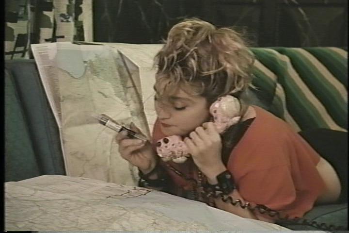

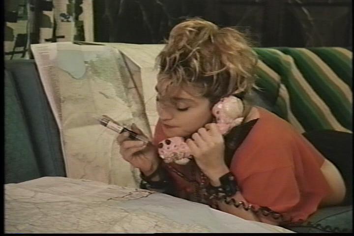

WOW!!! I shut myself away from this site for a while so not to be influenced by anyones judgment of this recorder. I finally got some me time and been able to play with it a lot more. However, it looks like all the bases have been covered. I am by no means any professional, I only do this as a hobby.
I recorded some programming off of Direct TV and am very pleased with the quality. Like I said before, a lot better then the previous 4 standalones that I tried. I think as a DVD recorder it is great. It makes me want to keep it. I still have a few days.
As far as a dubbing machine, well I'm not so sure. I dubbed from the VCR (and yes it was a little confusing but once you get the hang of it it works) and recorded from an external VCR (JVC HRS-3800) with an external TBC (datavideo 1000). Here are some stills. I chose a movie that wasn't to new cause most of the stuff you record to dvd is older. This movie seamed to be right in the middle as far as it's usage.
DR-MV1 dub
External VCR with TBC
What do you guys think? -
It seems to actually "punch up" the saturation, not just maintain it. Also, the image is smoothed out a little as well. Nothing to jump up and down about, mind you, but a little something is still better than nothing.Originally Posted by lordsmurf
Now, if I could only stop that annoying smearing at the top of the screen.
I've played with the picture control options (norm, edit, sharp), as well as the 'on/off' option for the video stabilizer, both of which are accessed by the "set up" buttom for the VCR side. The video stabilizer does eliminate the problem, but then introduces an annoying freeze frame effect, as if screen image gets hung up for a quarter second every few seconds. Like the smearing problem, this only shows up during playback/recording on the dvd side of the displayed image. Again, none of these problems appear on the VCR displayed image.
tommyoz - thanks for posting the screen shots.
To my eyes, and viewed on my monitor, the second image looks darker and/or more color saturated. Sharpness and detail appear to be very similar between the two. Seems like a toss-up to me.
My monitor is showing some age spots, and I'm not sure how well it's calibrated, so take my comments with a grain of sea salt. -

Originally Posted by GregN
All I can do is add a "ditto" to Greg's post........very similar on my 21" display with the exception of color saturation.
Personally, though, I prefer the top image; it's simply more "natural looking" to my eyes. Some, I'm sure, will prefer the bottom claiming the top image appears too washed out. My response to that would be, "yeah, the top image does appear to be "washed out" but only in comparison to the bottom image". -
It is a bit washed out.
But the PC RGB will look different than a TV YUV.
Only tommyoz can tell us how it looks on his tv for sure.Want my help? Ask here! (not via PM!)
