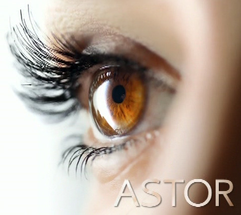

Okay - I think I found the answer. It is NOT required to deinterlace progressive sources.
I apparently lost a small amount of quality doing it unnecessarily.
Unnecessarily deinterlaced with the "Deinterlace - Smooth" filter. Compare the eyelash. Some of the fine lines have stairs in them. Compare the letters "ASTOR", they look the same.
