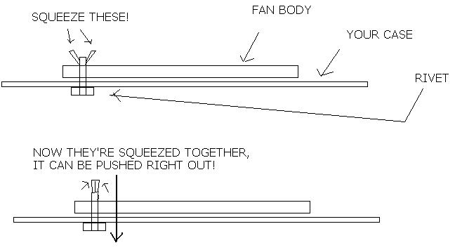

Look on the inside of the rivet. It will be plastic that's splayed out. Pinch the two sides together firmly with tweezers or your fingers if it's a big one, and that will make it the right shape to slot through the hole!
Here's a (badly drawn) diagram I made in Paint to try to illustrate what I'm saying.
Hope this helps!

I am truly impressed Cobra. Drawings to go along with a good set of suggestions. The bar has been raised for the rest of us.
