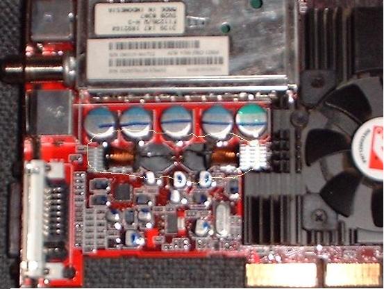

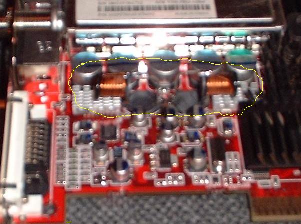

So , you all ready for this . I pulled the card and looked at it like a ham radio operator would . There is an R.F. problem here . I studied the board layout for about an hour .
This is what I found , there is two R.F. chokes right under the tuner . On the back side of the board was the Theater 200 chip , where all the magic happens . Well the R.F. chokes are doing what those are supposed to do , but the cores being magnetic were passing a large spur of crappy R.F. into the Theater 200 .
The fix (THIS IS NOT EASY AND IT IS!! USE YOUR JUDGEMENT HERE PLEASE!! YOU CAN BRAKE THE PARTS!! DON'T GO CRYING TO ME IF YOU DO!!) Now if you see those two coils I have been blabben about great . I unsoldered one lead from each coil , just the wire not the mounting pad . The two leads where the coils are closest to each other . Not by the chips with the heat sinks on top of them . I heated the base of the coils to brake down the glue that held them there . The coils will pop free from the plastic base that are undernieth them . That base should stay right there . Now with the card in front of you componet side up , card pins pointing toward you . The coil on the right turn it to the right 90` . The one on the left turn it 90` to the left . Now both should be hanging just above the chips with the heatsinks . Now add a small bit of wire from each coil back to where those where connected before . DONE !!
My card works perfect for capture . The tuner I have a feeling that this should take out the noise there too (but untested). I can't say this will work in all the cases I have read about this card . For me , this fix , made this good card Great !
Please be aware that not all the ATI AIW 9700 Pro's are the same . If you look at your card and its not the same as I instucted DON'T DO IT!!! If you CAN NOT see how easy this fix is DON'T DO IT!!!
GOOD LUCK !!

Ty in a knot:
Is your card modification just changing the coils to a vertical, rather than horizontal position (visa versa if the pictures are after the mod)?
If so, in layman terms, why would this have an effect? -

Great question.
Ok, now anyone ever made an electric magnet with a coil of wire wrapped a nail and hooked it up to a lantern battery. I'm sure some of you might have done this is school. What happens is you get a magnet. Where the ends of that nail has the strongest pull where the magnetic lines of flux are the strongest.
That is the same effect here in these two coils. But here they are supposed block AC (digital noise) and pass DC. The AC (noise) is supposed to be dissapated in those cores, but at the top and bottom of those core that AC(noise) is the strongest. It passes through the board and induced that noise into parts of the singal path to the Theater 200 chip on the other side.
Both of the pictures are the modified ATI AIW 9700 Pro.
Now can this happen in other boards, yes. But I'm not telling everyone to get out their soldering irons and start moving parts around. I just found this to be the problem I had with this card alone.
Hows that .

ok , Here is the 9700 AIW that is on the site.
I have a bastard board
. I have the plug pack of the 9800. The 9700 I have is very similar. My board has the 9700 heat sink. Lucky me to get the one and only board that grow up to br the 9800
