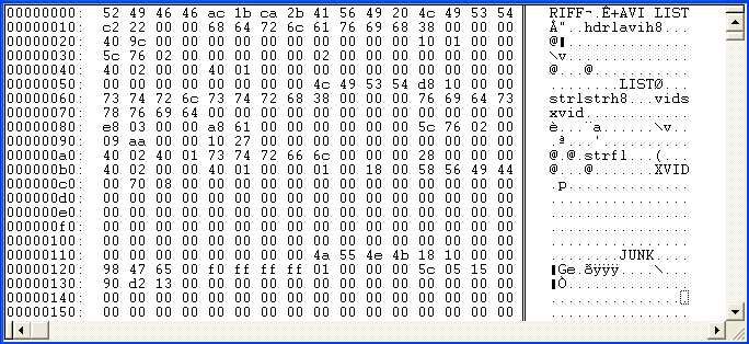

A hex editor lets you examine the "raw" contents of any file. It just gives you a byte-for-byte view without any knowledge of what the file represents. Here's a free hex editing program, HexEditor: http://www.hhdsoftware.com/hexeditor.html
When you open your XVID file (use a backup copy!) with HexEditor you will see something like:
The bytes you want to change are the first ones on the lines beginning with 00000040:, 000000a0:, and 000000b0:. Notice they are all the same value here, 40. That's hex, not decimal (more on that below). The locations of the latter two may not be the same in all AVI files, but they were the same in a dozen different xvid and divx files that I looked at.
The file displayed above was a 576 pixel wide xvid video, hence the value 40 at the indicated locations (and the value 02 immediatly after -- 0240 hex is 576 decimal). AVICODEC indicated your file was 636 pixels wide so you should see 7C (027C hex is 636 decimal). You can use Windows' Calculator (in "scientific" mode) to convert decimal to hex and back.

In HexEditor you can change a byte by clicking on it and typing in a new value. Try changing the the indicated bytes from 7C to one of the following: 78, 79, 7A, 7B, 7D, 7E, 7F, 80. Then save the file and close it (other programs won't be able to access the file while HexEditor has it open). Finally, open the file it VirtualDub and see if the problem is fixed. If not try another value.
A word of warning: since you are manually changing the image width in the header of the AVI file, any video program (even windows itslelf) that's reading the file may get confused and crash when you open the file. Be sure you're not running anything critical while running these experiments. -
