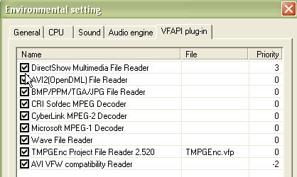

    I use TMPGenc Plus . The only enviromental setting is to set the DirectShow Multimedia File reader to a higher priority. See pic.
