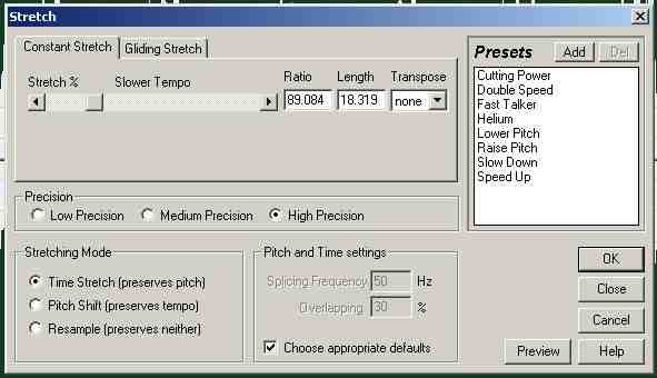

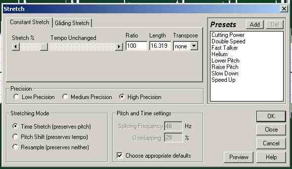

When you get to the Stretch menu, make sure you have the stretching mode (lower right of the window) set to TIME STRETCH (preserves pitch).
Also, make sure you are using CONSTANT STRETCH (not gliding stretch) -- it is a tab at the top of the window, and is the default.
From here, you can work with the stretch% slider. As you move it to the left, you will notice that the ratio changes and will say SLOWER TEMPO. This will make the clip longer. You can see the new duration in the LENGTH box. A ratio less than 100 makes the clip longer, greater than 100 makes it shorter. A ratio of 100 would leave the clip unchanged.
For pitch and time settings, I check the "select appropriate defaults" box.
For precision, there are three settings. The higher the setting, the greater the quality of the shift, but the longer it will take to correct. For final work, I always use high precision.
Here is an example. The first picture is of the settings for making no change (100%). The second picture has the settings for stretching to make the wave file 2.000 seconds longer.
