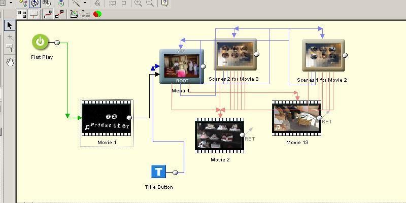

Btw, attached file is the connection I've made. Movie 13 is the clip having this problem. Movie 1 and Movie 2 works fine. Or could it be that there's something I've done wrong in the connection? -

That's really weird. If you don't have chapters (well you have one - the whole movie) a clip has to start from the beginning. Actually if a clip has more than one cell or program you can start playing it from each cell/program but DVD-Lab can't create this (not that I know of; but I may be wrong). Seems like a bug. You might want to report it.
Is Movie 13 just a regular MPEG2 elementary stream? If it's a system stream (I noticed from the screenshot you have audio as well) try demuxing it first to elementary streams (video + audio) and import them separately. Also try authoring only with the video in Movie 13 (to eliminate the posibility that maybe it's the audio that's causing this).
Have you ever used IfoEdit? If so, open the VTS_01_0.IFO file and check how many titles/PGCs you have. There are many ways to author what you're creating but the "most correct" way would be to create two titles (one for Movie 2 and one for Movie 13; Movie 1 should go in the VIDEO_TS.VOB file) with one PGC each. Movie 13 should only have one program and one cell with a total length of 5 minutes. If it's not like this contact the author of DVD-Lab for support. Maybe you've discovered some bug. -

Anyway, after following your recommendation "try authoring only with the video in Movie 13", I'm pleased to report that after removing Movie 2 and authoring the dvd with only Movie 1 & 13, it works perfectly! Even more interesting is that, when I add clip 2 again, and reauthoring it, everything works as it should now. Weird huh? Don't know why it didn't work before
