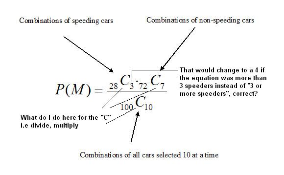

    The reason I ask is that I am currently doing a statistics course for university and was wondering if anyone could help me out with the following problem.
    On the Ipswich Motorway near the Warrego Highway turnoff, it is
    known that 28% of vehicles exceed the 80 km/h speed limit. If 10
    vehicles pass a hidden police camera, what is the probability that
    more than three will be booked for speeding? Give your answer
    correct to four decimal places.
    My logic would say that the percentage of 3 or more being booked is 0% seeing that only 10 cars pass through and the percentage of speeders is 28% therefore every 2.8 cars is a speeder.
    What do you think? Perhaps if I rounded it up?

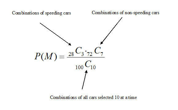

    OK, now I will confess my statistics is very very rusty...8 years worth of rust.....But lets go this way....
    Since the speeding and cars stopped are mutually exclusive events. The probability of the "UNION" of both circumstances. Therefore P(A U B) = P(A) + P(B).
    Now it would be nice if we could just say...well that would be 3 out of 28, and 10 out of 100, do some arithmetic and be done...but alas, that is not the case.
    Lets rewrite the problem so it's more comfortable for me. From a group of 28 speeding cars and 72 non-speeding cars, 10 cars are going to be selected at random. What is the probability that 3 or more speeding cars are selected.
    OK, now there are no stipulations on which of the 28 cars are selected...making this a combination problem!!!!!!
    In case you were sleeping in class...combination is ---> n! / r!(n-r)! or if you have TI-86 calculator it is ..... 2nd > math > prob and will be the "F3" key nCr....if you don't have a TI-82,83,85,86,89 or 92 calculator...sucks to be you, have fun with the arithmetic
    Anyway...to the problem...
    Now we have some situations here, first we need to determine the probability of if being exactly 3 cars. We will call this P(M), then we will need to determine the prob. if all 10 are speeders and we will call this P(N). Because remember we just have to have more than 3...so "3" is a minimum and 10 would be the max.
    we will follow this same process for the P(N).
    So the combination in the picture comes out to be:
    P(M) = .278788048385
    P(N) would be done a little different as we now do not have any that are NON-speeders in the mix. So our combinations would be (28 C 10) / (100 C 10)
    P(N) = 7.58109497293 x 10^-7 or --> .00000075810.....
    So the Probability of P(M U N) = P(M) + P(N) which is .278788048385 + .00000075810 = .278788806495
    WHICH as you can see is very close to 28%...but is not 28% and would be counted wrong because statistics professors are loser bastards who are WAY to anal about the accuracy of the work.
  9. Thanks for that Northcat_8.
    Now I just have to adapt that method for more than 3, instead of 3 or more.
  10. There is probably a blindingly obvious question but I suck at anything to do with statistics so here goes.
    No that wouldn't change to a 4.
    3 is a minimum....the question reads "more than three" ...that means anything greater than 3.
    3.1
    3.000000000000001
    The problem that you are having with it is that you know what a car is and you know you can't have 3.1 cars on the road....statistics does not recognize that. You have to have AT LEAST 3 to satisfy the conditions of the statement.
    P(M) = Probability of 3 cars = .278788048385
    P(N) = Probability of 10 cars = .00000075810
    What we have found with the P(M) is the probability that exactly 3 cars that are stopped will be speeding....the P(N) is the probability of all 10 cars stopped will be speeding. Notice how the P(M) is almost 28% and the P(N) is so small? The range between the two is the probability of them being over 3 cars.
    SOOO...you were asleep?
    The combinations are written n C r
    P(M) that I attached.
    n = 28
    r = 3
    So from the long equation I wrote above n! / r!(n-r)!, you would have
    28! / 3!(28-3)! = 28! / 3!25!
    Remember now "!" means factorial. Which means --> 5! = 5 x 4 x 3 x 2 x 1 = 120.
    So 28! = 28 x 27 x 26 x 25 x 24 x 23 x 22 x 21 x 20 x 19 x 18 x 17 x 16 x 15 x 14 x 13 x 12 x 11 x 10 x 9 x 8 x 7 x 6 x 5 x 4 x 3 x 2 x 1
    Which equals: 3.04888344612 x 10^29
    304,888,344,612,000,000,000,000,000,000
    which is $5.00 short of Bill Gates' net worth
    I sure hope you have a graphing calculator
    I also hope this is how you were suppose to do the problem...there are about 100 ways to do it depending on what part of statistics you are dealing with.
