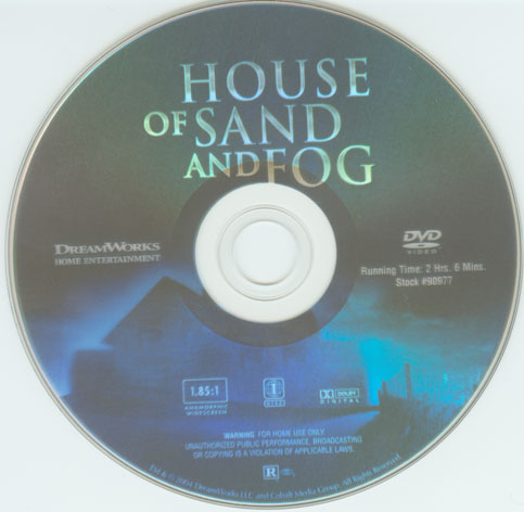

  15. My update
    Just got my order of ProDisc silver top inkjet from supermediastore today. Burned 3 so far without any problems.
    I ran them all through dvdinfopro for read errors
    Burned 4.33gb, 4.29gb, 4.30gb
    To tell ya the truth, I think my next order is going to be the white tops. I really don't care for the iridescent look to the disk...
    Printed at
    Best Photo
    Premium CD/DVD
    +1
    one pass through
    I was going to post a scan, but it really didn't look the same as the DVD printed....Imagine a pearl texture to a DVD
    Originally Posted by jagabo
  16. OK here's a scan.....
    The lighting sucks next to the left and right side of the text. This is due to the refraction of the silver matting of the DVD. What I have found is that the darker the image being printed to these silver tops the better. I printed using the best possible settings with +1 setting
    BTW, I did burn a coaster with the ProDiscs. My fault as I was doing a little to many multi-tasks... I decided to dropped the printed coaster in hot (real hot) soapy water.....The ink released instantly...About 2 minutes later, the coating of the DVD released. Just a plain ole silver coated DVD was left. The coating that released was like geliten or a real lite glueish stuff[/img]
