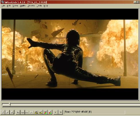

    I hope you have better success with VOBEdit. However, Virtual Dub mod has always been able to load VOBs. Just make sure you have the "mod" version. For instance, this image is loaded into Virtual Dub mod, from a Matrix: Reloaded VOB (of course):
