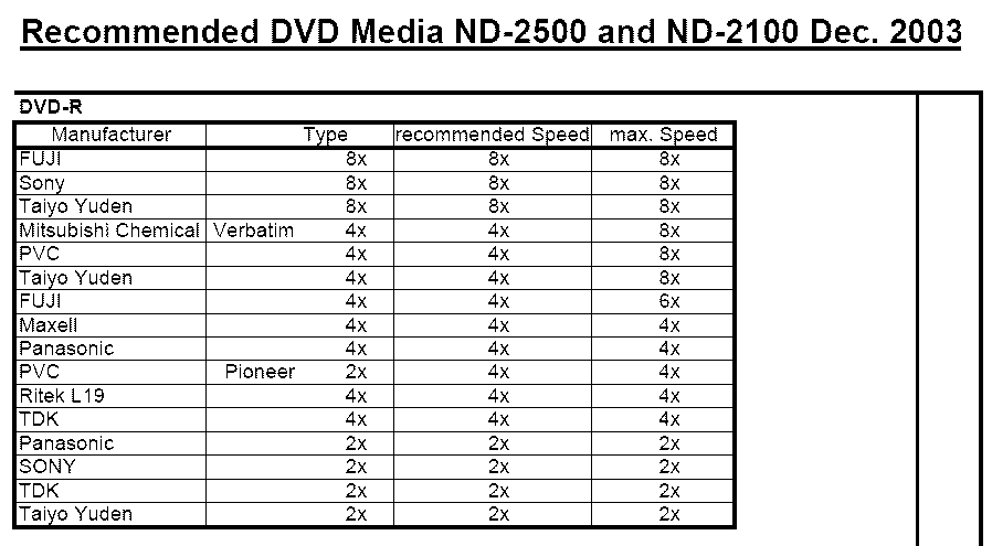

    NEC says that the only approved Ritek media is L19.
    L19 is the serial listed on the tiny text around the hub (something like H4-3L19305164889D00)
    H is the factory, 4 is the floor, 3 is the line. I think 30516 is the date code 2003/05/16. BTW, this was the code from a coaster :P
    L19 is the dye type, so all G04 should be L19.
    Try Herries 108v4B firmware with your NEC1300.
    Also note that there are 3 or more Ritek G04 formula variations.

    L19 is for 4x Ritek DVD-R media. It's from the NEC site for supported media.
    The NEC 1300 is a dual format burner?
    BTW for others, the herries firmware is a hacked/patched firmware for the NEC drives. He has also done great work on the NEC2500 (like >NIL with the Pioneer drives).

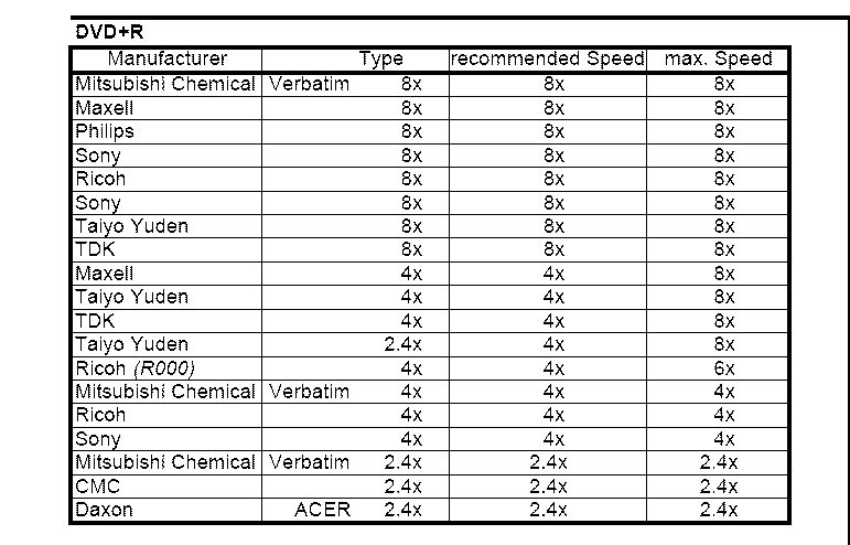

    No, L19 is the dye code DVD-R 4x media. <- or were you just saying it is dual format?
    http://www.nec.co.uk/DVDRW_ND2500.aspx
    Which seems to be down, so here is a snap shot of the PDF
