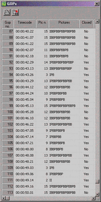

    here is this in action -- notice the scene change

  7. BJ_M,
    What tool did you use to create that GOP report?

    May 2001
    That's the commercial version of Bitrate Viewer. Every serious DVD creator should have a copy.

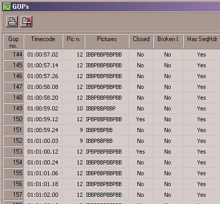

    here is another shot from a different movie i made ... the GOP pattern can be all over the place in high action

  12. BJ_M,
    Mixed open and closed GOPS in the same stream? I thought it was one or the other! So, when I tell my encoder (mainconcept) that I want closed GOPs, maybe I'm not...based on what? scene changes?
    Originally Posted by BJ_M
    yes -- bitrate viewer commercial version

    only select closed GOPs for two reasons , 1 - your dvd authoring app requires it (there are a couple) , 2- you plan on editing the mpeg file ..
    in main concept select open gops and scene detection ...
    you can mix open and closed gops in the same stream .. but not all encoders can do this ..
