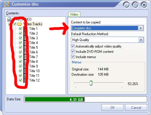

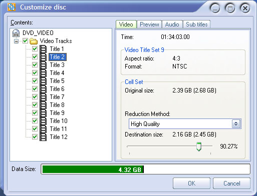

See the following screen shots:
this is a normal un-hidden settings editor'ed DVD. You can see that the file size says 4.32 GB...this DVD contains both the 16:9 widescreen and 4:3 full screen versions. Everything except the 4:3 version is compressed to 30%.
Problem with this picture is you see the 4.32 GB?? Well adding file sizes up by hand with my trusty TI-85 calculator, Suzie (...it's a long story), we find the real file size to actually be 3,602,910,000 bytes...which translates into an actual file size of 3.36 GB...which is almost a whole GIG short of what I could have and rather than compressing at 90.27% I could have 100% quality OR...I could split the difference, run the 4:3 version down to say 85% and use that extra % to raise the 16:9 version up to acceptable, or keep subtitles, or keep extra audio...you get the idea. -

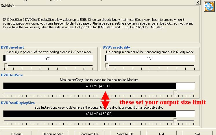

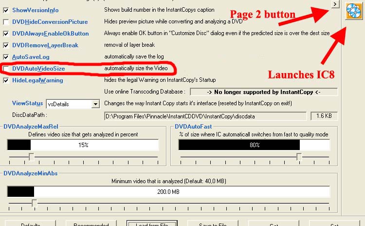

These next 2 are hidden settings editor.
Although this is a mrbass.org...you need to uncheck the autosize check box to prevent IC8 from automatically adjusting your size (long arrow pointing left). Always enable the OK button will allow you to start the encoding even when IC8 reports you over the 4.32 file size limit. If you are having difficulties, your video card maybe to blame, you can select "hideconversionpicture" and you won't see IC8 convert the video...could be your problem...it didn't crash minimized but crashed when you brought it up.....just something to think about.
Page 2 of the hidden settings editor. The 2 things at the bottom set your file sizes. Now keep in mind that IC8 does not calculate file sizes appropriately. You can see where mine are set.
Now with hidden settings controlling the IC8 program, I can run my file size (green bar) up to 4.5 GB before it turns red. You will want to figure the file sizes by hand anyway if you want to be 100% accurate. It's pretty easy......444,333,222,111.....the 4's are GB, 3's are MB, 2's are Kb, 1's are bytes. so in my post above with IC set up 2.45 GB would be entered into the calculator as 2,450,000,000 bytes. Something like 5.83 MB would be entered as .... 5,830,000 bytes. Once all file sizes have been added up and totaled, divide that total by 1024, then 1024, then 1024 and the decimal on your calculator is your correct output file size.

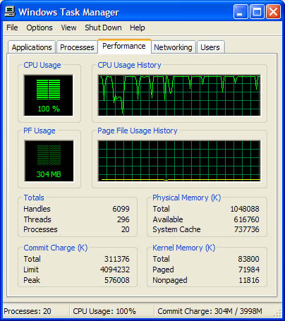

I took this screen shot right around the 77 MB mark of the menu....my CPU is running at 100% and the little decline spikes are from when it was "testing video quality".
You said your system resources were at 24%...what Operating system are you using? I'm going to need some system specs. System resources is different than CPU usage. If you are using Win98 or WinME, 24% of your system resources is not very much.
Also, I noticed during this process that the amount memory (RAM) being used by IC8 fluxuated between 8,900 K to 120,000 K, that's a pretty wide range depending on how much RAM you have installed.
Even doing a movie only my CPU ran at 100% and IC8 was using 107,396 k of RAM.
Again, I don't know your computer specs but...
I would make sure you close down all background programs and try to free up as much ram as possible.

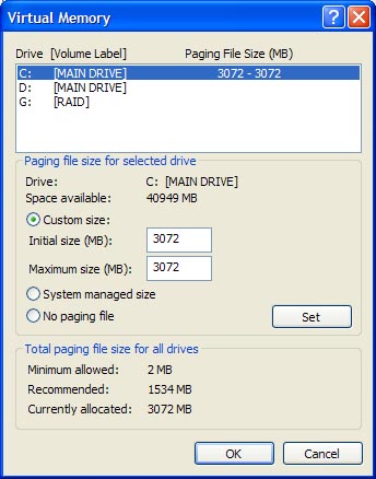

I would also set my page file. If you are using XP you go to control panel > system > advanced tab > performance button > advanced tab, set processor scheduling and memory usage to "Programs". Then click on the "Change button" in the Virtual Memory settings.
In this window you will see your hard drives listed at the top and in the section below that you will see 3 button holes, saying Custom setting, System managed, No page file. If you have never played with it, it is set by default on system managed. You need to select Custom. Then in the white boxes beside that you will need to type in a number. The number you type in there is 2x or 2.5 x ever how much RAM you have. So if you have say 512 MB of RAM, you should type in 1024 (2x) or 1280 (2.5x). You should set both the minimum and maximum to the same size.
Setting your virtual memory to the same size in both places prevents your page file from becoming fragmented which will really slow your page file down. Your page file is used like RAM but is stored on your HD rather than RAM sticks.
If you are using Win98 or ME, you can find virtual memory in control panel > system > and I think it's the far tab on the right of the device manager window...not sure, my laptop is Win98 but it's been a while since I was into those settings and it's at work. If you can't find it, go to help and just search virtual memory, they should be able to take you to it.

I don't know if this will help your situation or not but I'm perplexed as to why your CPU is not running at 100%, which I believe it is...if you have a faster processor it will just use 100% of that and encode faster.
Running another test, reading and writing and having the temp folder all on the same drive....I noticed IC8 spiked the RAM usage up to 128,832 K...noticed as it starts encoding the CPU no longer runs at 100%...hovers between 39% and 80%.
I don't know.....let me dwell on it for a bit....do me this favor, in your hidden settings, select the "AUTO SAVE LOG" and see what it says when it crashes.
EDIT at 10:05pm EST
Not to rub your nose in it, but I have tried and tried and I cannot get IC8 to crash. For purposes of your issue I did install IC8 on my PC using my friend's install disc.....RELAX PINNACLE....I uninstalled it, I went back to my upgrade...IC7...I don't like IC8 and I refuse to use it.........but anyway, I can't get either of them to crash
....the auto save log may provide some insight

I took you advice and unckhecked dvd auto resize in hidden settings and it WORKED ...Freaky Friday done.
The only thing though is it didn't show the video even though the setting was unchecked?Then I tried another movie and it crashed but you could see video
So I then deciided to reinstall IC8 but there was a repair option on the IC install disc so I clicked it and it add some files to the computer. I tried the second movie again and it crashed again. So I sat back analyzed the situation and decided to try checking the hide video and it worked , so now 2 back-up ccompleted and working flawlessly in the dvd player...COOL.
Now I just finished the third disc and again no crash . It's burning now...hopefully no problems playing.
