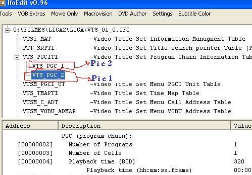

    After looking really deep into it, i found out, that when i press Play, the film starts in chapter 4 (not in chapter2, as said in previous messages).
    I try to solve this, and i use DVDRemake to see where the missing chapters were.
    After hours of research, I noticed that in the original DVD, when you press play, it begins reading the chapters in the file VTS_PGC_2 , and them jumps to the file VTS_PGC_1 and reads the following chapters until the end of the film.
    I found out, that chapters 1, 2 and 3, are in the file VTS_PGC_2 (picture 1), and chapter 4 and ahead are in the file VTS_PGC_1 (picture 2).
    Further more, i also found out, that on the contraire to the original one, here, when i press play, it begins to read the files in VTS_PGC_1.
    Now, what I want, is just to be able to press play and the film start in chapter 1 like its supposed to!
    Did I make myself clear now?
    Thank You very much.
    Regards,
    João.[/img]

    First, noone owes you anything. Second, probably noone knows a suggestion to fix your problem.
    I have a feeling IFOEdit might be able to help, but I don't know in what capacity. It sounds like we just need to set it to launch PGC_2 to start with, and then put a jump to PGC_1 at the end.
