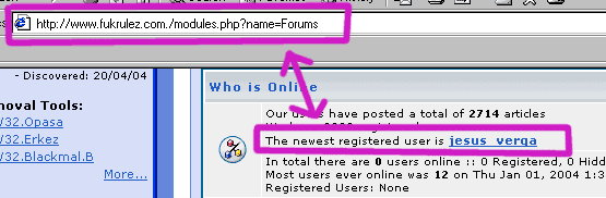

  19. on Apr 23, 2004 @ 17:06, remmark said
    "Register to be a member of this website www.fukrulez.com. Then go to download section/audio and download Sonic Foundry soft encode. Remember to read on the "comment" of this software, that's where you can have it works"
    warez...
  20. Video Restorer lordsmurf's Avatar
    warez...
    Am I the only one that finds this amusing?
  21. No, you're not the only one.
