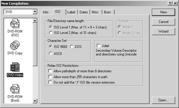

Burnt 100's of +r (ALL at X4 - Ritek and Tayo Uden + 1 mirror) with this drive using nero 5.5.10.42 and ZERO coasters (had the odd 1 using -r, cheap princos)
using latest F/W 2.50
heres the setting I use in nero (hope its of some help)
p.s. using no multi session setting. -
