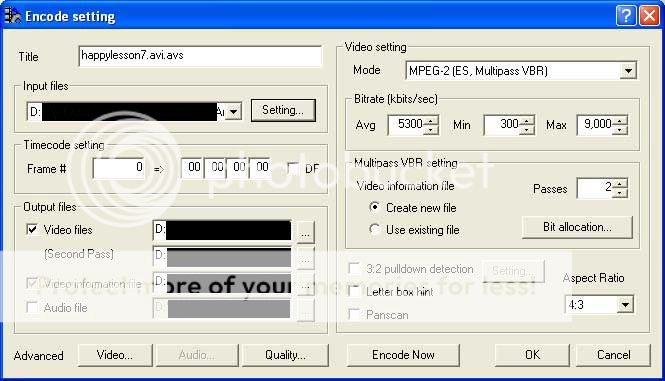

I think I've found my problem. In the CCE settings for the multi-VBR I put the max bitrate at 9000 but when I ran two of the videos through bitrate viewer they had a peak bitrate of 10829.
I'm gonna try setting it at 8000 for the max and see if that doesn't help, but if not then I'm just gonna go back to TMPGEnc. -
You have a good angle. Remember current DVD-Video format is a MAX of 10 megs per second bitrate.
OK, I put the settings for CCE SP multi-VBR as min=2000 avg=5230 max=8000. After re-encoding the two videos and running them through bitrate viewr they peak out at 9886.
I'm pretty positive now that this is what's causing me the problem with DVDit!, but can't understand why CCE SP when set to 8000 for max bitrate it gives me video that goes past 9800.
Has anyone else had these kinda problems with bitrate using CCE SP? I want to use CCE SP cause I do notice better quality than TMPGEnc, but am I going to have to set it at around 7000 just to get the bitrate to be compliant with DVD. -

Bitrate spikes happen occassionally.
What paramaters are you using within CCE??

which version of cce are you using ? I know that CQ set to 1 will cause cce to go aff the map at times (15,000 peak one time) in some versions even when max is set to 8000

CCE is set to ES multi-pass VBR (2 pass)
bitrate: avg:5300 min:2000 max:7000, 7500, 8000, 9000 (tried all 4 and end result is still 9800 on all tries).

Drop your min to 300.bitrate: avg:5300 min:2000 max:7000, 7500, 8000, 9000
Uncheck your "Make DVD compliant".

Are you saying that the actual bitrate in your bitrate curve spikes above your set max? I have absolutely never seen CCE do this with multipass encoding. My guess is that you are just looking at the nominal bitrate as listed in BitrateViewer. This really has nothing to do with your actual bitrate, its just a flag set in your stream. As pijetro stated, you should not use the DVD compliant option in CCE. Among other things, it tags the nominal bitrate as being 9800kbits regardless of what your actual max bitrate reaches, and this can cause problems in some dvd authoring programs. I also agree that you should lower your min bitrate setting much lower. 0-300 sounds good to me. Raising the min bitrate only decreases quality arbitrarily. You shouldn't do this unless you run into specific hardware problems with very low bitrate video, which very rarely ever happens.
BJ_M was referring to the 1-pass VBR setting in CCE. I guess it doesn't adhere to your set max values in this encode mode as well. I didn't know that. -

Well, that is how you would check max bitrate. Maybe checking the DVD compliant box not only sets the nominal bitrate to 9800kbits, but somehow screws with your max bitrate setting as well. I honestly don't know but what I do know is that, oddly enough, if you want dvd compliant files you probably should avoid the dvd compliant option. Its really not necessary and causes problems with authoring packages. Just give it a shot with this option unchecked and I'd be willing to bet that at least this problem will go away.

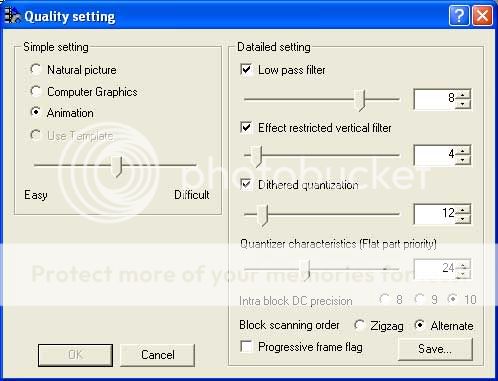

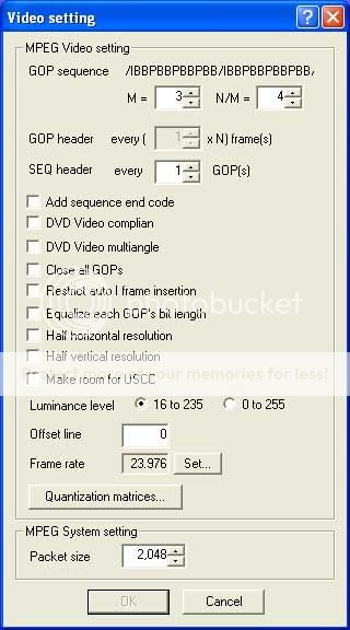

). Just to be on the safe side, here are the settings I am going to use for my next go:
Does everything look alright there? -
is this a re-encode of a dvd ? if so:
lum. level to 0-255
turn off all filters and set quantizer level to 30
scanning order to zigzag
progressive frame flag - on
max bit rate to 8500 (just a suggestion)
3 pass
dont know what matrix you used .....
add seq end code
are you sure aspect is 4:3 on original ?"Each problem that I solved became a rule which served afterwards to solve other problems." - Rene Descartes (1596-1650) -
looks like you may be encoding animation ?
use cg smooth matrix"Each problem that I solved became a rule which served afterwards to solve other problems." - Rene Descartes (1596-1650) -

Anoter note on the bizarre behavior of the dv compliant checkbox.
I was encoding 352,480 video and had dvd compliance checked. It added black borders until i twas 720x480 and ruined the video. Won't make that mistake again. (This was cce SP 250)
CCE makes me laugh. If you want dvd compliance, UNCHECK dvd ompliat. If you want upper field first video, UNCHECK uper field first.
Was this program written by monkeys? -

there is no 100% correct answer for every type of file -- i just am posting what would work for me .. others will still (sure as the sun will rise) have other settings they use ...Originally Posted by chanchan
what you have there is fairly typical settings for animation -- the quantizer level can go some lower for lower bit rate and/or live (interlaced) material"Each problem that I solved became a rule which served afterwards to solve other problems." - Rene Descartes (1596-1650) -
