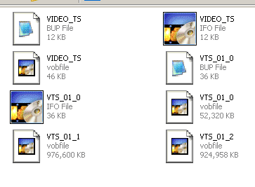

Hi,
I am trying to add a VOB intro to an existing movie I made. Bascically I just renamed the VOB files in the VIDEO_TS folder so that my intro was VTS_01_0 and then renamed the others respectively. When I went to burn, the status window in Nero said something about the VOB file not being found in the IFO file? Is adding an intro not as simple as that? Thanks for any help.

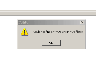

1st, a VTS_01_0 file is usually a menu rather then part of the movie. So if it's ok for your Intro to automatically play upon dvd insertion with the movie to follow (without menu options), you could try renaming the VOB's with your intro as VTS_01_1 and so on. Then you could use the "Create IFO's" option in IfoEdit to create the new dvd components. Then try burning that with Nero (a RW disk first in case you're headed for a coaster)

Originally Posted by Noek
I'm lost a bit....I'm not sure at what stage that "snapshot" of the Video_TS folder that was taken.
Is it after you added Intro and renamed Vob's? -
Oops, you're right I forgot to specify. That is my movie folder. I have a seperate file named VTS_01_0 that is my intro that I want to add to that folders contents to play at the beginning. It is not currently in that folder, but is on my desktop at the moment.
ok then....I think I know what you have.Originally Posted by Noek
1st of all, as i said above, I don't know of a way you can simply add your intro to your existing dvd folder and maintain the functionality of the menu. I'm not saying there is no way....I just don't know of one.
You'll have to decide if you want a dvd that includes the intro and movie along with a negotiable menu, or simply a dvd that automatically starts with the intro and plays through to the end of the movie.
If it's the second option, create a title set for the Intro/VOB using IfoEdit as I mentioned previously so you'll then have 2 seperate dvd folders(You'll have to rename the Intro file which apparently is now VTS_01_0 to VTS_01_1 first though)...one for the Intro and the one you have a snapshot of above. Then use DVDShrink to reauthor a new dvd with both dvd folders.
OR: take your Intro which is currently named VTS_01_0 and rename it to VTS_01_1. Then go into your main dvd folder and rename the 2 VOB's VTS_01_2 and VTS_01_3 and put them in the same folder as the intro VOB. Then you may be able to use IfoEdit to create a functioning DVD....
...I say MAY be able to because if your Intro has a different resolution or audio or bitrate then the movie, I don't believe you'll succeed because this method would only create a single track and all components need to be the same.
If you want to make a DVD with a menu, then you can use the method with ReJig I described before.
