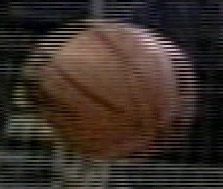

    That doesn't definitively exclude interlace as the problem. Some broadcast show non-interlaced material. If you're "ghosts" look something like this small 4x blowup:
    then you are seeing interlace problems.

    That is fine for still images, the full picture is restored. But a problem arises when objects are moving. The second field of the video was taken 1/50 of a second later than the first field. Moving objects are not in the same place. As you can see in the picture I sent a while back, the basketball has moved between the two fields.
