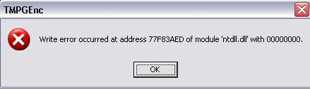

  3. i got this message

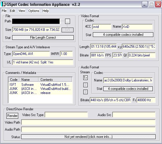

    here the file

    Your audio is AC3, you can use it as-is to make your DVD, converting the video only, or you can use Goldwave (sorry mis-spelled it before) to convert it to wav and then TMPGEnc to convert to it MP2.
    I recommend leaving it alone, here's a guide on how to handle AC3 audio for DVD's.

  9. Simple mistake - you had the video in Full Processing Mode...
    So when you go to Save to Avi, your little friend tries to save an uncompressed video (i.e. the 12 gig)..
    Switch Video (and audio for that matter) to Direct Stream Copy and you ll be fine
