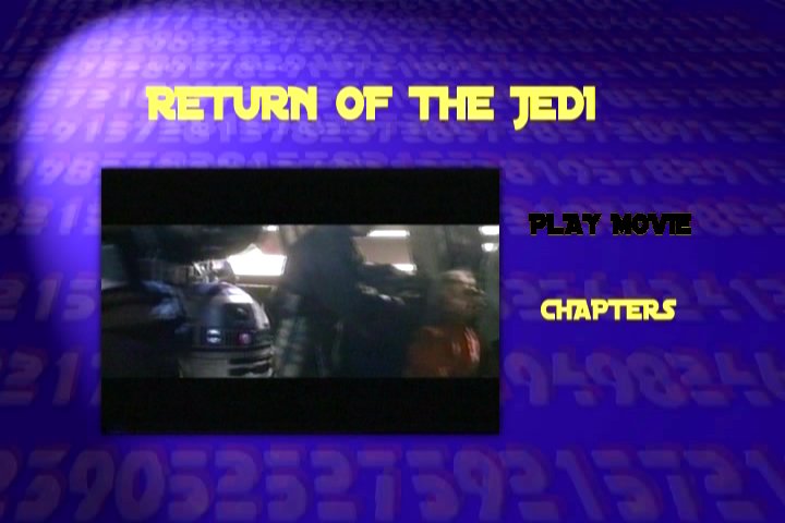

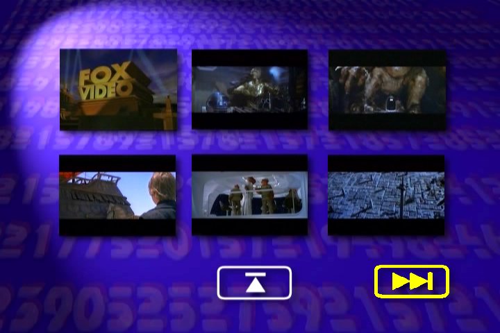

Originally Posted by frugalbrutus
and this:
were created using the links above. Basically, it's a motion menu with thumbnails. The "scene selection" menu is the same way. The only thing that "plays" is the movies inside the boxes...
both loop for approx 20 seconds, then repeat
