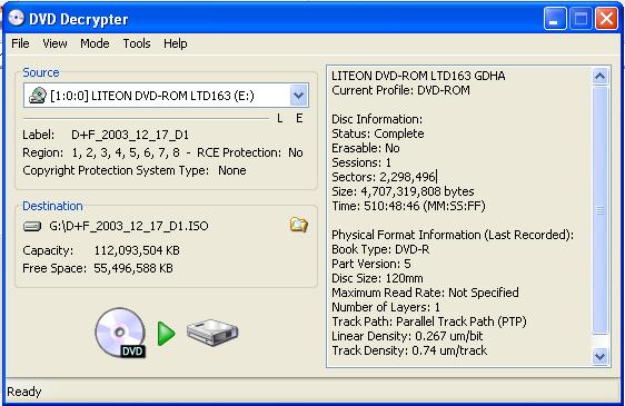

I'm not familar with a "Nero image file" but I'd be curious to know the sector count of the original disc given by Decrypter, or even Decrypter's sector cound of one of your burned -R's.
here ya go, check this out...the sector count on the original burned disc...anyone know what to make of all this?
no way man, i Have 55 free GB of space...where do you see that?
Dave
