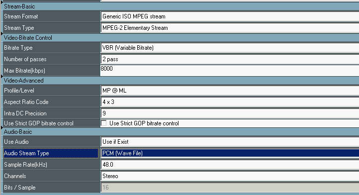

The reason why the color was different on CCE and MC encoders maybe the luminance settings. Tmpgenc has a function in the mpeg settings under the Quantize matrix tab called Output YUV data as Basic YCbCr not CCIR601 that states it is to be checked for DV footage. Normally this is unchecked by default and I assume this is the way you encoded since the color looked the same. There are threads here that have said this should never be checked even with DV footage as it only compresses the luminance further. DV footage I have encoded has had best results with this setting unchecked, the colors were like the source.Moreover the color especially red is the closest to the source encoded in TMPGenc. In CCE and MC the red is more orange (lighter or more yellow). In both cases.
For CCE the luminance setting is found under Template, standard, video. On mine the default setting was 16-235 which produced color changes from the source like you described. When I set it to 0-255 it kept the colors accurate.
