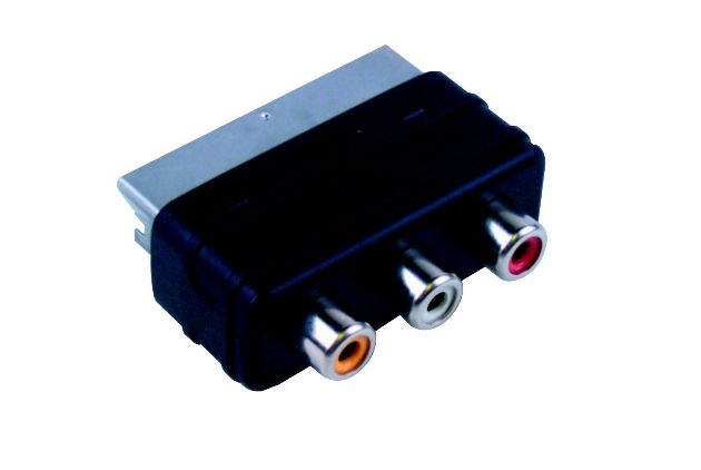

The composites on the front on the video recorder are 'Inputs' not
outputs, are'nt they?
You need to get a Scart to Composite adaptor that plugs into the scart socket on the back of the video recorder, they're cheap most TV/Electrical shops will sell them.
Heres one at Maplin.co.uk
Save your money.
On your VCR you have to set the A/V channel to run through your front composite A/V port.
For example, on my capturing VCR I have to change
the channel on the front console to read AV 2 (other channels are mostly regular free to air TV stations)
See your VCR manual for setting up A/V. -
