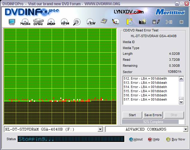

What happens when you get a disc like this in the mail from someone who uses Memorsux DVDR's...
....and SWEARS he could not have sent me a bad disc since he uses nothing but quality Memorex DVDR's?
I must admit....I started to laugh out loud immediately.
I stopped the test at 517 errors because I believe I had seen enough.....and it was nowhere NEAR the 99% mark yet.
I have NEVER had any of my Ritek(so called superior media) show ANY errors.
ONE error is too many....even at .64 cents each. -

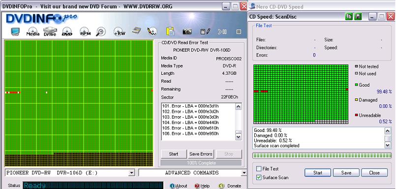

DVDInfoPRO (regardless of ASPI/SPTI) and Nero CD Speed give similar results.
Scan of a scratched disc.
On one of my slower machines, I can cause Nero CD speed to read an error by moving the mouse around.Originally Posted by lordsmurfHope is the trap the world sets for you every night when you go to sleep and the only reason you have to get up in the morning is the hope that this day, things will get better... But they never do, do they?
