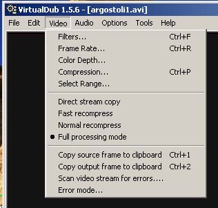

    was just following a guide, and when i ran into sound problems, i was unsure what to do....i have done it now tho using ffmpgui (i think thats what its called) and am happy with results....thanx for the help....i ran into a problem with video in tmpgenc earlier.....712mb file (xvid) it was converting it for me, and all was going well till it got to 96% then a smal box appeared saying stream error, i clicked ok and lost the 96% it had already done.....im guessing i need to fix the avi b4 trying again right?
  13. Member daamon's Avatar
    Join Date: Jun 2003
    Location: Melbourne, Oz
    Try using VirtualDub :
    ...to "Scan video stream for errors..."
    Hope that helps.
