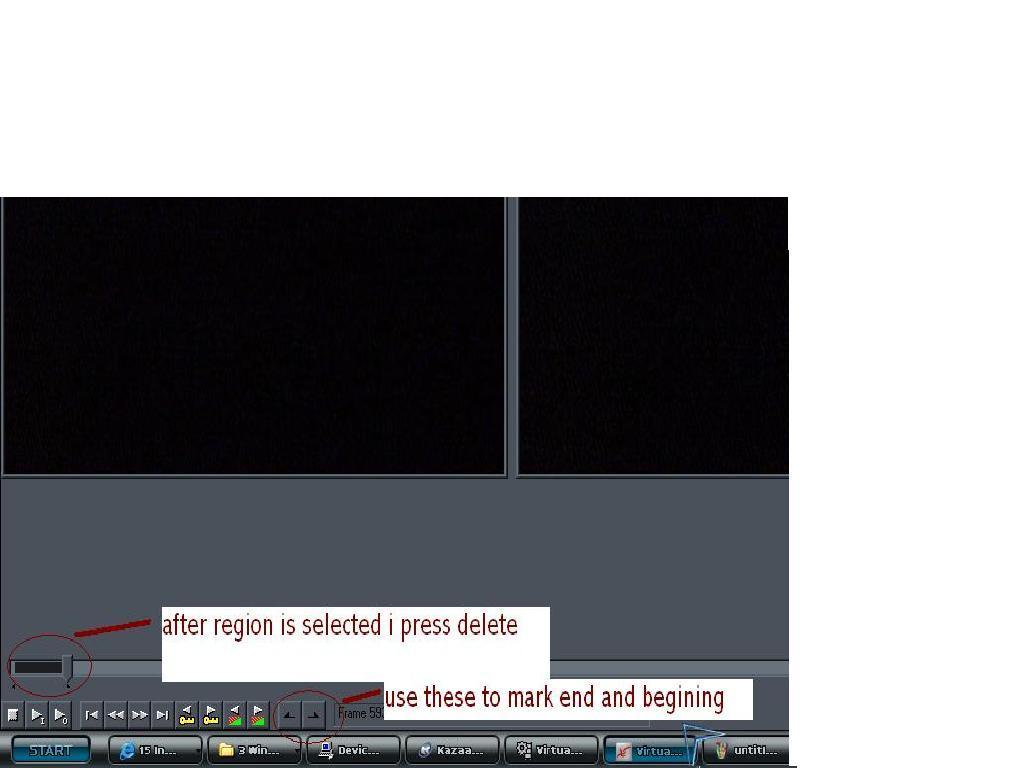

  5. Sorry if i was not that clear. I was capturing from the TV in MPEG2 format and the audio codec was MPEG 1 Audio Layer-II . This was the default that came with my capture card, WinFast 2000 PVR. It has options to record using different codecs but for some reason when i change the video codec to XVid or DivX and use MP3 at 128kbps ,44KHz , stereo it wont work. So i have to capture using the default settings it came with.
    What i do using Virtualdub to cut out pieces of avi is first load, the i use the slide ruler at the bottom and use the start frame tool and then go to the end frame tool and put it where i want to cut it. So the two rulers will black out a little portion. Then i press delete and that portion of the avi (or frames) is cut out. I saw it posted on another post hear on the forum. But again, the sound does not get cut out, only the video.

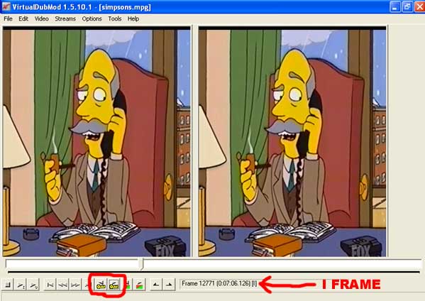

    OK here is a picture from VirtualDubMod with a MPEG-2 file loaded:
    Notice the box I put around the two buttons that look like KEYS
    If you use these you will go from I FRAME to I FRAME since I FRAMES are the KEYFRAMES in MPEG-2 files.
    Not every frame is an I FRAME or KEYFRAME. There are only so many out of "X" number of frames. I looked at the very start of my SIMPSONS MPEG-2 file and found that FRAME 0 was a KEYFRAME with the next KEYFRAMES being frames 15, 25, 33, 48, 63, 78, etc.
    So again you can ONLY place a CUT on a KEYFRAME and with MPEG-2 files the KEYFRAME is the I FRAME
    Also notice the BIG RED ARROW points to where VirtualDubMod tells you what kind of frame you are on. I know it is hard to see (I had to reduce my original image down to 75% original size and use heavy JPG compression to make it fit within the file limit of our beloved forum here) but if you look you can see this ---> The letter "I" in parenthasis
    Now ...
    In MPEG-2 you also have B and P frames.
    So as long as you make your edit points on KEYFRAME aka I FRAMES you should be A-OK
    Also when you load the file ... make sure you do your edits FIRST then go ahead and set your compression for the VIDEO and AUDIO ... not sure if this really makes a difference but that is how I've always done it.
    So give this a try and let us know how it works for you

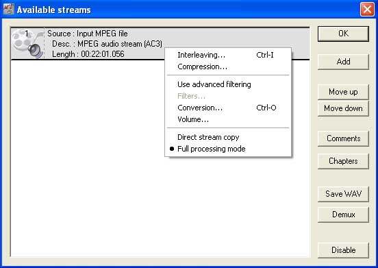

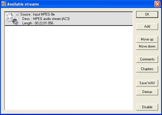

  12. Member FulciLives's Avatar
    May 2003
    Pittsburgh, PA in the USA
    Sorry I forgot that the new VirtualDubMod has a different interface ... it is even new to me as I was using an older version up to just a few days ago.
    Anyways here is how you get to the audio.
    At the top click on STREAMS and under that click on STREAM LIST
    The following dialog window pops up:
    If you double click on the grey area it is the same as clicking NO AUDIO in the old version. It will put a checkermark type pattern all over the grey area. So we don't want that.
    Instead RIGHT CLICK on the grey area and a menu comes up as in this next picture:
    This menu look familiar?
    Once you are done setting your compression etc. simply click on OK which is at the rop right.
    Then you are done with the audio part. The video part has the same interface. When you are ready to save it is under FILE as SAVE AS (F7)
    I tested it ... it worked for me. The converted AVI (I used Xvid and MP3 audio) was in good shape
    Hope this helps ... again let us know how it works for you
