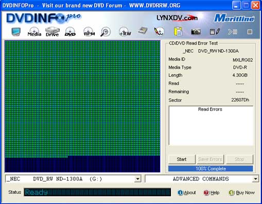

Read and weep
MAXELL 4x DVD-R (MADE IN JAPAN)
READ ERROR TEST with DVDInfoPro ... NO ERRORS
SPEED TEST with DVDInfoPro ... NO ERRORS
I had to reduce the screen caps down to 80% and use heavy JPG compression to get them to a size that I could post here but I think you can still make out the detail.
Again NO ERRORS ... as in ZERO
Suck it down my friend ... suck it down.

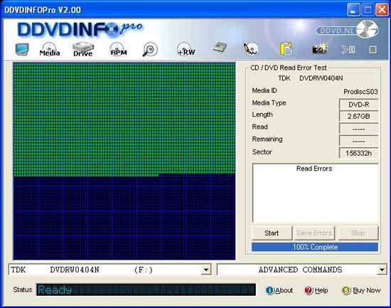

Why is the MEDIA ID missing from your pic?Originally Posted by shelbyGT
That seems very odd to me!

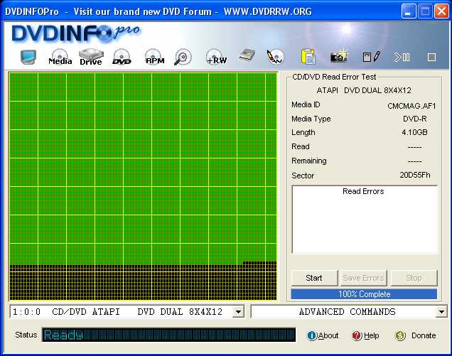

because I used an already burnt dvd, not a blank one. Trust me, it's a memorex cmc. If I had more on hand, I'd post the results from a blank one, not a burnt one. However, I don't at the moment.
/edit - wrong, it's because i did the test on my dvd-rom, not on my dvd burner. Here is a pic of the actual media info: (man I suck at editing these things)
I didn't mean to start an all out war regarding media. I was just trying to add to Fulci's kind post about good prices on media. I was unaware of the difference in media manufacturing at the time.
That having been said, I have run some more tests on the CMC and Ricoh "Memorex" media that showed read errors on my home "burning" machine. The DVDinfopro program on my new office HP computer disclosed no read errors on the same media. Thus, it appears Smurf was right that my home DVD drive (a TDK DVDRW420N ) was responsible for the read errors at the edge of the recordings. As reported previously, both disks play just fine on the computer and set top.

the screen shot posted above was almost at full capacity (okay, so in Roxio it said there were an additional 16.7 MB left on the disk before I burnt it, but that is what it always says. Pretty much all of my CMC's are burnt at max, and they all still play till the end.Originally Posted by LRD
