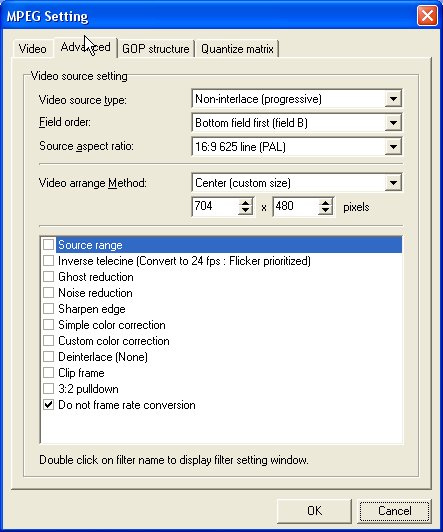

ok, since there isnt any avisynth script for that vcd conversion, i followed basically what you wrote for ams30gts in that second link.
here are my windows, tell me if im still wrong

On the MPEG SETTING ... VIDEO TAB
Change VIDEO FORMAT from PAL to NTSC
Then ...
On the MPEG SETTING ... ADVANCED TAB
Change the VIDEO ARRANGE METHOD from CENTER (CUSTOM SIZE) to FULL SCREEN (KEEP ASPECT RATIO)
Otherwise everything seems to be in order assuming this is a PROGRESSIVE 16x9 PAL DVD source.
Oh yes one last thing ... I usually use HIGH QUALITY (SLOW) as my setting for the MOTION SEARCH PRECISION on the MPEG SETTING ... VIDEO TAB
As for the audio don't forget you need to change it by slowing it down from 25fps to 23.976fps which can be done with BeSweet and either the BeSweet GUI or AC3Machine as a front end.
