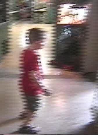

    For the life of me, I cant figure out what I am doing wrong?
    The lines, the blurriness, the horrible video quality. Any suggestions on making this better would be fantastic.
    I used vdubmod for the capture, no compression. I tried different filters to help (deinterlace, blur, sharpness, etc((all different dubs))) but no success. My capture device is an ATI aiw 9200 coming in through svideo off the hi8 camcorder. The tape looks soo much better than the capture.
    Would a better capture device help me here or am i overlooking something? I get this same quality (none) when I capture through mmc 8 to mpeg2 with videosoap going. what gives??

    May be the field order. Should be top field first for analog capture.
  3. Those lines are due to interlacing. The question becomes what are you trying to do. If you are planning to encode to MPEG2 then output to SVCD/CVD or DVD then don't worry about it. You're TV is setup to display interlaced source material (requires it in fact) and it'll look fine.
    If you final output is VCD or for the PC (both are progressive source only) then you'll want to deinterlace yout video. There are several ways to do this (do a forum search or check out the guides at http://www.doom9.org). The 'simpliest' way is to capture at directly to VCD resolution of 352x240, ie. only capture one field.
    VDub and AVISynth have deinterlace filters that work pretty well. I know you said you tried it already but there are a lot of settings/variables and suspect that one of them was not configured corrected. Good luck..

  7. Hola Kolosus and thank you for your insight.
    I rechecked my connections from the camera to the breakout box to the card inputs. This is a frame captured in mmc mpeg2, no soap applied
    This is a motion shot but it depicts what I am dealing with through most of the video.
    I do not have the tv cable plugged into the PC but will go out tomorrow and purchase some coaxial to test the capture.
    For capture I have tried vdub, vdubmod, vdub+vcr, MMC, Vegas, and a couple of others. Whether I capture in AVI, MPEG2, or DV, my quality still blows. I have also used various codecs for compression (huffyuv, mainconcept, etc) along with no compression at all. The video still blows. I also tried without capturing audio, but this didnt do any good.

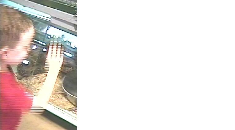

  14. I finally got the '352x480 lordsmurf method of capturing' to dvd. I THINK it is better. It seems more clear than before.
    One thing that was very obvious was some type of distortion in some pic frames. When I saw it I automatically thought of a Jerry Springer episode. You know that effect they use to cover up the boobies? That is what I am seeing at different places. I did cut out a portion of the captured mpeg file that shows this distortion happening. Now, if I can show it to ya'll here....
    In this clip, my daughter has a boo boo on her ankle. The distortion is prominent around her foot/calf. Although throughout the video there are places when this distortion shows. Sometimes subtle, other times very apparent.
    example.mpg
    This was captured with ati aiw 9200 mpeg2 with no videosoap using mmc following lordsmurfs methods and advice on his kickass site.
    Can I get rid of the Jerry cover up?

    Out of curiosity what BITRATE did you use for the video? I've found that Half D1 (352x480) hits the MAX at around 5000kbps. Once you start dropping below that it is possible to notice some compression errors here or there although it doesn't really get all that noticeable until you drop below 4000kbps
    So knowing what video bitrate you used would help.
    - John "FulciLives" Coleman
  16. FulciLives,
    I am using a variable bit rate. The settings are as follows (using MMC):
    Max Bit Rate- 4.03 M bits/second
    Target Bit Rate- 3.92 M bits/second
    Motion Estimation Quality- 98 (I assume this is 98% of max 15 MB)

    Settings seem to be OK though you might want to try a straight CBR of 5000kbps or 5.00 M bits/second
    I'm not sure how ATI measures the MOTION ESTIMATION QUALITY thing but 98 I guess is pretty high assuming 100 is the highest.
    Are you getting any reported dropped frames? Also you are capturing at 29.970fps for NTSC right?
