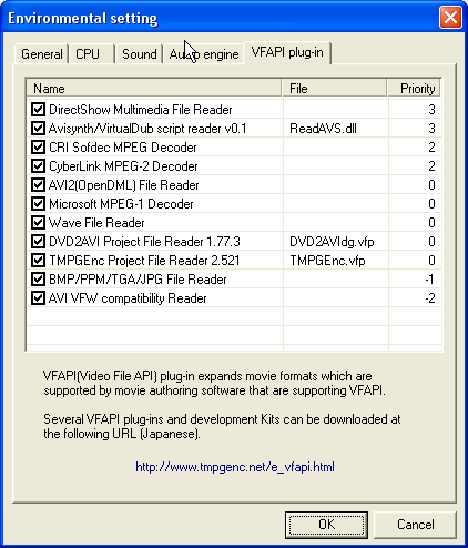

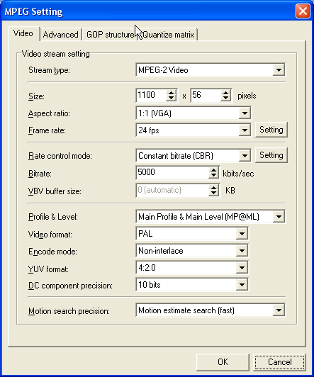

    I used it before and it worked well, I have to format my CPU, so I wonder if I installed something wrongly. I don't think it is an environmental settings problems in TMPGEnc Plus problem. Anyway here are some shots from the different programs I'm using.

    And here is the result once the avs file is loaded:
