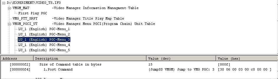

Here is the offending PGC (Program Chain). In this IFO, it is VMG_PGC_3. This is the one that we want to prevent another PGC from calling.
The command here just jumps back into itself (an infinite loop).

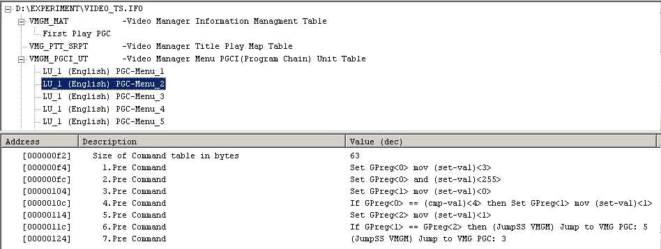

Here is the first place that calls ol' PGC3. It is VMG_PGC_2.
Since this is the last command, we just want to redirect the DVD to the last (and only one on this page) good PGC. Here, it is PGC5, so we want to change the last command to :
(Jump VMGM) Jump to VMG PGC: 5
This will allow you to be able to go to the Video Title Sets, where another "check point" awaits.

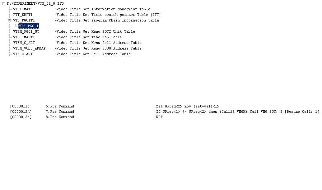

This next one is in the VTS of the main movie.
For this command, we just want to "avoid" the jump back to the VGM_PGC_3, so we just change this command to:
NOP
