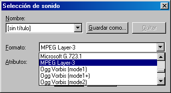

Actually, Iīve just checked the resulting file with AVICodec, and the sound file is now a Lame MP3...your 'wav' file is probably still an ac3 file - hence no sound after encoding
I extracted it with Virtualdub Open video file->"Audio"Full processing mode ->"Audio"Conversion->Save Wav.BTW how did u extract your wav and what size is it + how long?
The size is around 450 Mb, and itīs around 42 minutes long

Right, I know more or less now whatīs happening. Virtualdub is indeed giving me a Wav file, but apparently TMPGEnc, when encoding, converts the wav into an MP3 file. I might have to change the settings.....So, let's see: You're extracting the AC3 from an Xvid using VirtualDub and getting a file.wav that's actually an MP3. Has your PC been drinking?
Iīll try to make TMPG to encode the audio file as ac3, īcause I know for sure that my stand-alone can read ac3...... on the other hand, it should handle mp3īs pretty well too (btw, my stand-alone is a liteon lvd2002).

Update: Iīve re-encoded it, this time when I checked the settings and I chose the PCM audio format..... same story, plays fine on my PC, doesnīt play on the stand-alone.
Now, there are two questions that are bugging me: A) Why I have no sound when I do the preview on TMPGenc before encoding, but I do have sound -on my PC- when I play the file after having it encoded?
B) Could it be that I need a serious update on my stand-alone regarding audio codecs?
BTW, I tried to encode the file using AC3, and after choosing everything it would tell me "Could not open this ACM Codec. This codec cannot be used for some reason" Iīd assume that this is due to the aforementioned incapability of the program to handle AC3īs, correct?
I donīt know, I think I should try it with another encoder.... Any ideas which one would get me there?

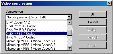

So, this is the first one.... Select AVI and then...
As you can see, you can choose both the audio and the video settings. Depending on what you choose, itīll encode it in whatever format.

OK - there's a few things going on here...
1. Thanks for the screen shots - I've never used that in TMPGEnc and so that explains my earlier comments (about what It cn encode etc.), and now my surprise. Because I've not used it, I don't know what exactly it does, so won't comment. That said, I'm intrigued and will (when I have the time) look into it more.
2. Because I've not used it, you should now be wondering how I've used TMPGEnc to get AVI to DVD compliant MPEG2 - the basis for all the info I've been giving you.
The good thing is, it's given me a clear understanding of what you're actually doing, rather than what I thought you were doing. And, I believe, there is now light at the end of your tunnel.

By the way, Iīve been messing around with TMPGEnc. Iīve learned more about it, and I can definitely tell you that it does more than MPEG1/2 encoding. Iīve taken a couple of screenshots for you, this is what you get when you click on settings on the last screenshot I posted.
Now that Iīve learned more Iīm sure I should be able to re-encode it using the same format.... but why donīt I get audio, during the preview or after encoding, I swear that itīs beyond my understanding.Darling, you ruined my life
So I hate you, and I always will...
