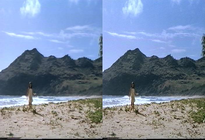

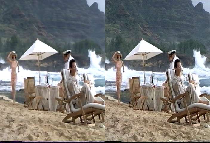

  1. I've been using a Sony SLV-700HF for my VHS to DVD conversions for the last few months. I recently picked up a Sony SLV-575UC for $1 at the thrift store and with $30 worth of repair parts it is now part of my capture rig. Seeing it sell for up to $130 on ebay, I figure I got a good deal. The difference in picture quality is quite noticable. The pictures are from my 700HF and 575UC (with the edit button on). The diffference is easy to see. Moral of the story, if you plan on making good VHS caps, check out a decent quality VCR. Oh yeah, the details: 368x480 cropped to 352x480 with huffyuv compression (convert to yuy2 and "best" setting) for both. I used avisynth to render them side by side and saved them as bmps with virtualdub. Then converted to jpg quality 6 and 7 (can't remember which is which) from Roxio's photo editing program.
    The sand even looks a different color in the first one...

    Impressive difference. And that is only with composite connections, right? Did you know anything about the SLV-575UC before you bought it, or did you take a chance just because it was cheap and you thought it was a bargain?
    Also, was that set for the sharpest picture on the SLV-575UC? My Sony SLV-740HF doesn't have a sharpness control, and although I really like my JVC HR-S9900U and its features, the one thing I have noticed is that it loses some of the detail that even my Sony can show.
  3. I didn't know anything about it other than it was a $1 VCR. The folks at the thrift shop rarely know what things even are, much less whether they work or not. I just buy up pretty much anything I see there. Yes, that was the RCA inputs to it. I've fooled around with the sharpness but it seems when you press the edit button, it overrides any tweaking of the sharpness control. It had an issue with dropped framesl. I've found that if I disable auto tracking and adjust it manually, it stops. It dropped 7 frames for a two hours movie. It seems to have trouble with my old 3 Stooges VHS tapes too. I guess I'll try the manual tracking "trick" on those too....

    It generally looks like the 575UC does a slightly better job, but it's hard to make a real comparison because of all the JPEG artifacts in all four pics.
  9. @ Brainstorm69: It's Jurassic Park: The Lost World (very early in the movie)
    @Capmaster: I think I have the original bmp files.
