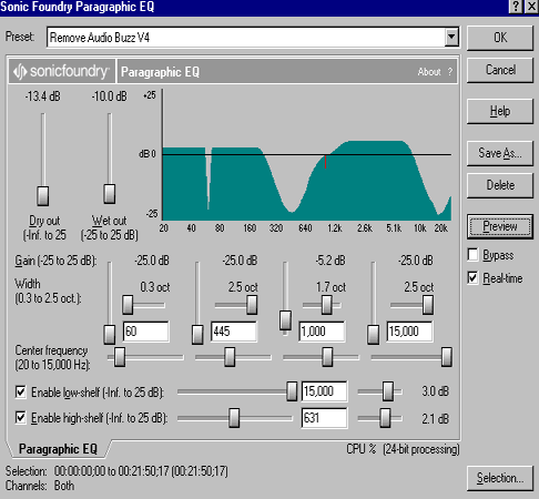

I had some buzz problems in some files. This took care of it, for the most part:
