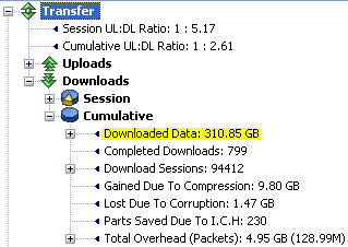

    In the last 78 days since I reset my stats, I've downloaded over 300 GB of data. The best thing about it is having files that aren't corrupted like almost everything I got off KaZaA. I recommend eMule and eMule Plus highly, as long as you set it up properly you won't have any problems.
    From my stats page:
    Ethernet (n): something used to catch the etherbunny
