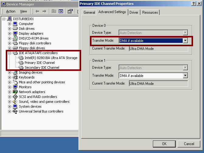

Hi - I may be wrong but it sounds like that old "DMA mode dropping down to PIO mode" problem. Have a look in device manager to see what the setting is for the port that your drive is on - if it's dropped down to PIO mode, remove the ide interface it's on and then do a search for new hardware.

I found the setting and on my primary ide cable both are set to Ultra DMA mode 4, but on my secondary IDE the first is set to DMA if available but the current transfer method is PIO and the second it set to DMA if available and current transfer is at Ultra DMA mode 3.
If I remember correctly my two hard drives are on my primary cable and my dvd-burner and dvd-rom is on the second cable. Device 0 is the burner, device 1 is the dvd-rom. I hope this info better describes the problem/system setup I have. -

Your earlier post means that your burner works in PIO mode! If this is true you have the reason for slow burning.
You should delete the IDE driver from 'My Computer' --> 'Properties' --> 'Hardware' --> 'Device manager' and reinstall it like Wc says. (Maybe this is WinXP bug).

I had this problem once. What I did was I went into device manager and selected the Secondary IDE Channel under IDE ATA/ATAPI controllers. I removed [uninstalled the secondary channel] then I rebooted the pc.
Upon rebooting, XP will find the controller again and reinstall it. Then, reboot. After reboot I went back into the device manager and checked the DMA and it was back to normal [DMA if available].
Don't know if it works for everyone. Don't know WHY it worked ... but it did for me. -
It worked. I just removed the secondary IDE driver and then scanned for new hardware and it worked.

Windows XP will drop a drive down to PIO mode if there are something like 5 consecutive errors on the device. (Windows XP used to drop the device into PIO mode after any 5 errors, then a patch changed it to 5 consecutive errors). The remedy is for this is to remove/reinstall the driver. This is documented on the Microsoft support website somewhere. The problem that I had turned out to be a BIOS setting. This is a great thread because there are MANY causes of device in PIO mode.
