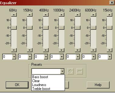

    i taped a friend's concert a few months ago, and im finally getting around to editing it. my problem is, that when i was filming, i was up close to the stage, and so the audio is distored in the video. it was my first time filming a concert, and i learned my lesson. but now im left with a video with crappy sound. its not heavily distorted so that you cant hear anything. theres basically too much bass since i was closest to the bass player when i filmed. is there any way to make this sound better? btw, i use premiere 6.5 and premiere pro

    You could load the audio into Gold Wave and select Effects-->Filter--Equa-
    lizer. Then have a field day with equalizer slides.

  3. you can see if eqing works but it probably won't do too much for you unless this was a softer concert than usual. usually right up at the stage without some kind of attenuation = unsalvageable.

    yeah ive tried to equalize it in premiere, but havent had much luck. i was standing by the bass speaker the whole time, so that totally washed out the audio. i guess i learned my lesson though.
