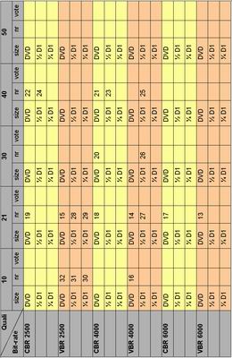

After I have read that interesting thread I started to make a lot of test with the MC 1.4 DV->MPEG-2 on-the-fly. After some tests I came in trouble with all the results and changes that I made, so I decided to make an structured approach with the help of an matrice in excel.
Here you can see a foto of it.
Quali: 10,21,30,40,50 refers to the quality slider in MC.
Size: I decided to check the formats DVD, 0,5D1, 0.25D1.
Nr.: The cell "nr." contains the name/number of the file (so my files-name are only 1,2,3 ...).
Vote: In the vote-cell you can write your vote or filesize or time or ...
Bit-rate: The bit-rates to the different bitrates in MC.
This approach was a great help to me:
1. to make the right tests and
2. secondly to evaluate and compare the results
3. not to waste time.
What do you think about it?
