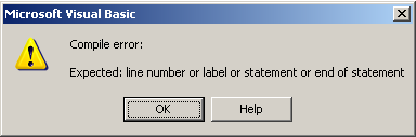

This is a problem with mixing HTML code with VB.
In VB, this gives me an error :Code:main.Text = " <!DOCTYPE HTML PUBLIC "-//W3C//DTD HTML 4.01 Transitional//EN" "http://www.w3.org/TR/html4/loose.dtd"> "
I know in HTML you can sub things like spaces for " ", but what will help me here in VB?[/code]

Hi,
Your problem is due to at least(Maybe others) the " characters in the string as VB thinks this is the End of your string. If you want a " character in your string you can use Chr(34)
eg
should be
" <!DOCTYPE HTML PUBLIC " & chr(34) & "-//W3C//DTD HTML 4.01 Transitional//EN"
Abnormal -
That helped me out so much. Where can I find a good list of the characters and their letter equals?
Hi,
Do a help search in VB for ASCI and there should be a ASCI character Table.
Also is "http://www.w3.org/TR/html4/loose.dtd"> " supose to be a new line as It is actually causing the error. If it is then you need to do something like this
Main.text = " <!DOCTYPE HTML PUBLIC " & chr(34) & "-//W3C//DTD HTML 4.01 Transitional//EN" & vbNewLine & Chr(34) & "http://www.w3.org/TR/html4/loose.dtd" & chr(34) & "> "
