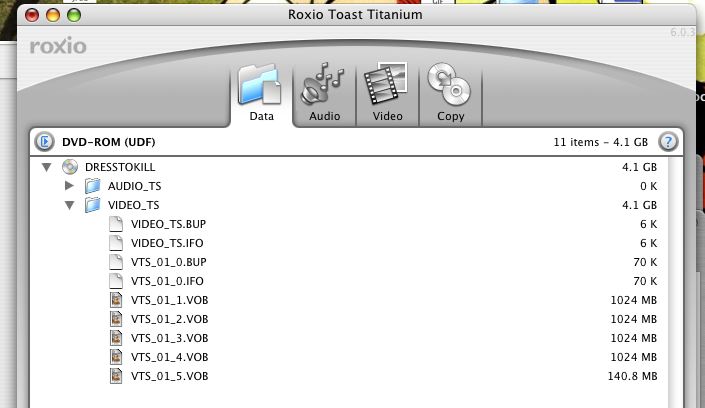

if its less than 4.4 gigs, just rip that baby over and burn in toast like you see in the picture.
If your not setting it up like its in the picture, then it wont play right

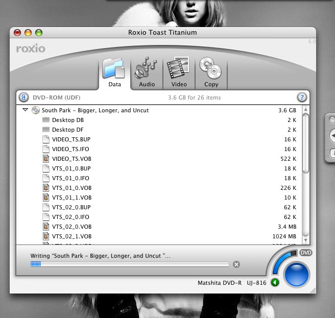

this is what im getting. after i rip the dvd to my hdd this is whats left.
You have to remove the Desktop DF and Desktop DB files before you burn. These files are created by the OS and are not necessary. Hope this helps.Originally Posted by JoeRodr
You're not burning it correctly.
You have to burn a VIDEO_TS folder, the files can't just be on the root of a dvd. -
Desktop DF and Desktop DB files go in there once i start the burn, i dont put them in there. i guess ill just make a Audio and Video folder.Originally Posted by jamerican
All you have to do is highlight the 2 files and use the - button at the bottom of the Toast window and they will be removed. Then you burn. They should not be recreated by the Mac OS when you do so.
Thanx to all I finally got it, pretty simple really. All I had to do was make a VIDEO_TS folder and not load all the files into the root of the dvdr. Also I used the add button on the bottom of toast. Thanx again
