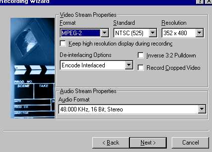

  6. ATI MMC 8.x captures MP2 audio by default. To select PCM you have to select 'MPEG-2 DVD' (NOT MPEG-2, as shown below) as your format from the 'Video Stream Properties' screen...
    ... and then you can select the PCM version of 48kHz 16-bit audio from the 'Audio Stream Properties' drop-down select. The one you see selected in the image generates an MP2 file, but the LPCM option becomes available once you go from MPEG-2 to MPEG-2 DVD.
    (Image from www.lordsmurf.com)
