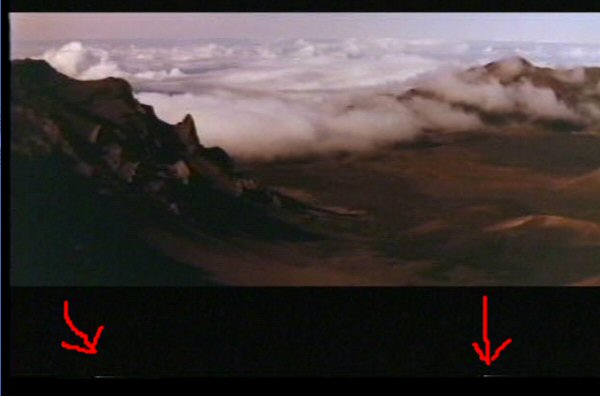

I'm foloowing the G4 guide here and so far I like it.
I am looking for a filter or somethign to strip the bototm tracking line that flickers occasionally only on bottom. I can't get rid of it.
Please don't even start telling me to buy a new vcr.
ALso, can you reccomend somethign that will give me a little more crispness.
I'm using GF4 comp in with virtual vcr, no filters.
I'm following the GF4 guide basically to a T.
Thanks![]()

If you`re going to watch this on tv then you dont need to worry about that since overscan will cover up that area.
Morning,
You could load it into virtualdubmod then use a null transform and crop to get rid of those tracking lines. You could also then use filters to sharpen and/or adjust other aspects of the video. The only downside is you would have to frameserve / re-encode to get it to an mpeg file.
However, unless you intend to play back on a PC/MAC then I'd agree with johns0 that you shouldn't see these lines on a TV anyway due to overscan.
Cheers
Edz -
With VirtualVCR you can use the cropping filter as you capture, but don't crop, just mask it. There is a checkbox to click if you want to mask rather than crop.
As far as sharpness goes, you could try a sharpness filter when you encode to MPEG-2. -

I think that line leaks above the bottom overscan. You can always clip/crop the image.
I would do the sharpness post capture. The more filters you use while capturing, the more cpu processing is required. If your cpu isn't fast enough, you will screw up your capture.Originally Posted by powrslave
If you use AVISynth you could fix it with something like this:
AVISource("whatever_clip.avi")
Crop(0,0,0,-10).AddBorders(0,0,0,10)
Keep cropping & adding a border line by line untill it's gone."There is nothing in the world more helpless and irresponsible and depraved than a man in the depths of an ether binge, and I knew we'd get into that rotten stuff pretty soon." -- Raoul Duke -

My recent captures were doing the exact same thing. It's on the very extreme bottom border. After I burned it and watched it on TV, it was fine, and I couldn't see it. It looks like your picture has a black border below the actual image. If that black border is part of your capture, then I agree with Lordsmurf, and that may be too much to count on the overscan to fix it.
Well thanks for your input but the beginning of this particular capture starts as a sort of widescreen footage then goes full scrren.
I'll try and watch it on TV on those parts but watching in media player for example they are visible thruout.
