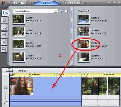

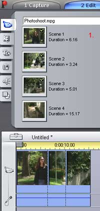

    1. Create/Edit video (you can do it later, but these are my steps)
    2. Select video clip that you would like to use as bacround video for your menu. In my guide I used scene 7. Trim it to the lenght that you want video repeat itself.

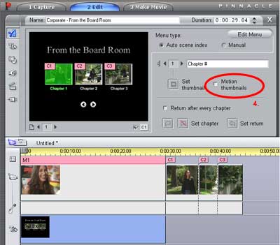

    3. Select one of the DVD Menus that are available and place it on "Title track" right bellow video.
    4. Optionaly you can make also thumbnails as "motion" by checking flag "Motion thumbnails".

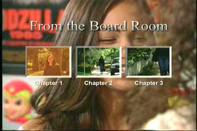

    Here you can see final result.

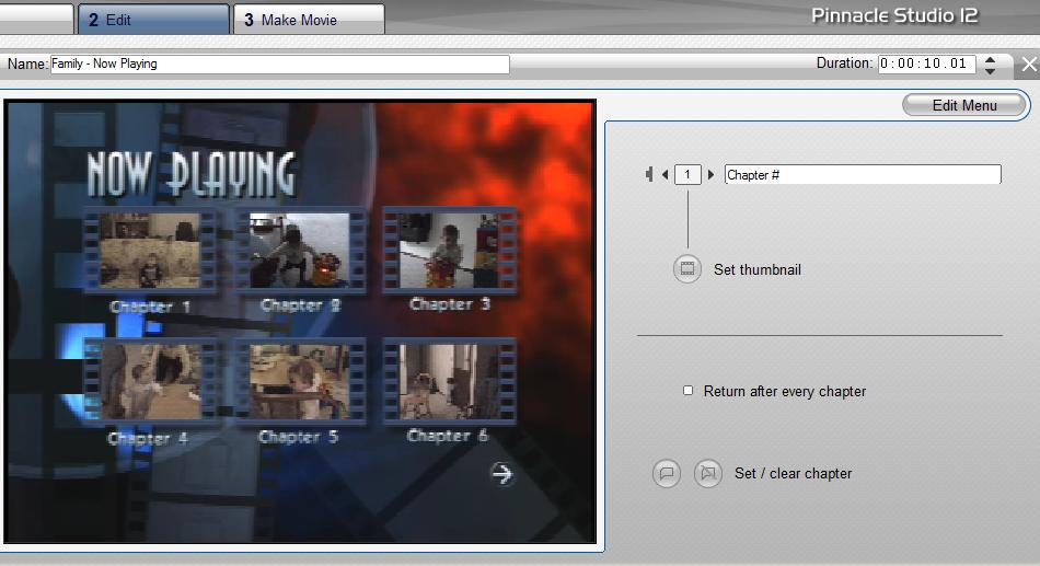

    This does not work in Pinnacle 12 for me. If i try and drag a menu onto the title track it says only pictures text and transitions can go on the title track. So, did pinnacle get a downgrade?
  24. The manual says you should be able to drag and drop video to make your own motion menus, but that doesn't work in Studio 10. However, I got it to work another way. Drop a menu onto the video track then edit the menu, select the background option, and then select the video clip you want as the background instead of a still, it works just fine. This works with Studio 10 Plus - maybe it works with other versions as well?

    I have Pinnacle Studio 12 and this is indeed not available.
    The menu properties doesn't even have the "Motion Thumbnail" option. See attached.

  26. Ah, you are talking about motion thumbnails and indeed, that option doesn't seem to be available in your version - definite downgrade. I am talking about a motion background for the menu itself - behind the thumbnails. The solution for a motion background I indicated is found when you are in edit menu (available on the top right corner of your screen), at least in 10 plus.
