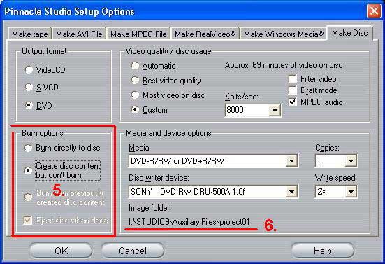

  1. This guide will show how to craete DVD content without burning it to DVD. Reason for doing this is that Pinnacle Studio can have trouble to recognize some DVD Writers or because you might feel that burning with different sofware will gain better compatibility during playback.

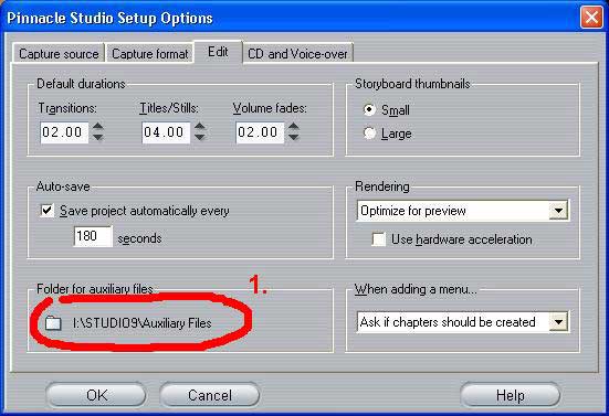

    1. Setup directory where DVD content gets created. Go to menu and select "Setup" / "Edit...". There select directory where you want to store your content (and temporary) files.

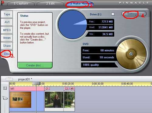

    2. Create your project. Edit all you need to do, add DVD Menu, etc.... When you are done and ready to create DVD, select "Make Movie"
    3. Select "Disc" option
    4. Select "Settings"
    5. Choose "Create disc content but don't burn" option
    6. Under "Image folder" you can see where to look for files. As you can see, subfolder was created with your project name.
    7. Click "OK" and click on "Create disc...".

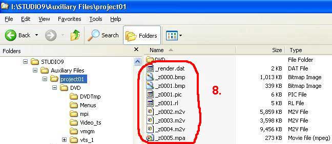

    8. In project directory you can find temporary video, audio, menu files that were used to make DVD content.
    9. In "Video_ts" directory you can find all the files that you need to burn with program of your choise. Since I don't
    realy know what are "Anchor" and "Volume" used for I am not burning them.

  5. Another reason to burn an image like this is so that you can tweak the content before burning with some additional tools, or make extra copies at a later time.
    To burn the image later with studio, choose the bottom button on the options tab ("Burn from previously created disc content") and let her rip. Studio will look for content in a folder under the Auxiliary file location with the same name as the project. I found that (with Studio8) it sometimes refused to burn if I'd changed the project at all.
    For me, (w/ Pioneer A06) Studio8 didn't like burning more than 1 copy - there is a dropdown box there, but if I used anything greater than 1, the first would burn, and the 2nd would either burn forever (and not burn anything past the lead in) or just eject the disk after burning the lead in. I have theories on that ... but storing these images was easier. So far its seems that Studio9 seems to be missing a lot of the burning flakiness that 8 had - especially after the 9.0.5 patch. I havn't tried making copies yet, but I have noticed that it is a lot better about burning at the chosen x1/x2/x4 speeds.
