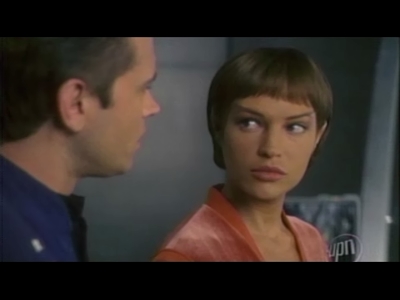

I'm fairly certain you're thinking of 16:9. Here's a screen cap I made of last week's Star Trek: Enterprise. The clip I am playing is a Divx conversion I made that has a 16:9 resolution of 480x270. Note: the software player I used automacticaly letterboxed the image. Otherwise it wouldn't have any bars at all.
Is that like what you're picturing? If your source uses this aspect ration it's still possible to create a valid DVD file. You just have to letterbox it so that the final image is 4:3. This can be done in TMPGEnc by going to Settings>Advanced and change the arrange method to "Full Screen(keep aspect ratio)". -
Yup that's what I'm thinking about. So what I don't get is that if this is 16:9, then what is the ratio of the widescreen movie format on a dvd like Star Trek's?
