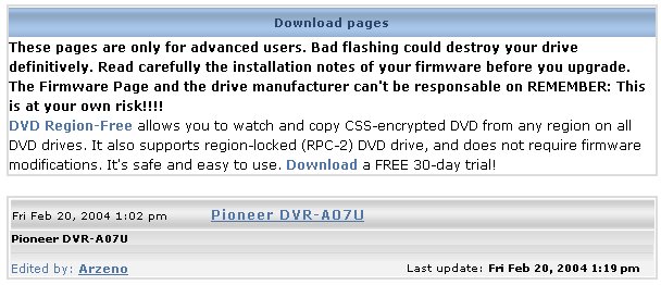

Hi there has anyone tried the new firmware here (http://forum.rpc1.org/dl_firmware.php?category=4&manufactor=25)
it has a version 1.09 for the 107D, has anyone been brave enough to try it yet.

I'm having trouble, every time I click I get sent back to the same page.Originally Posted by coblck
Have I got the corret page?
Willtgpo, my real dad, told me to make a maximum of 5,806 posts on vcdhelp.com in one lifetime. So I have. -
tried the link seems to work fine for me, mind your are looking for 107d,if that does not work try this link and click on pioneer for full lists of firmwares for all there drives, i notice they have 1.10 now have not tried that one yet upto you mind if you mess up flash your drive will not get exchanged mate but just follow instructions will be hassle free. Checked SVP your drive is 107d not A07u (i think they are the same drive but A07 is retail version, could be wrong) so i would wait until you install and see if what comes up in your hardware section and flash with correct firmware.
