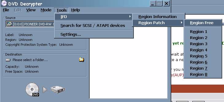

befre you go the add a region route make sure you really were region free this way:
Make sure your use the TOOLS in DECRYPTOR
and additionaly remove any region control enhancements not removed in the NORMAL DEFUALT RIPPING AND SHRINKING PROCESS
like so
